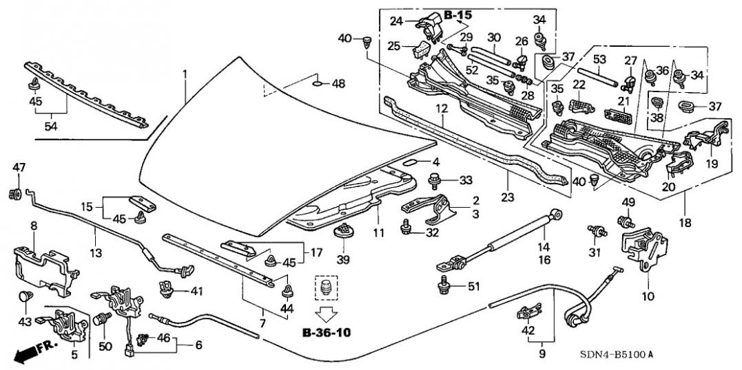

Old Jan 15, 2013 | 04:52 PM
Now I understand....
I bet the hinges (#2, 3) are in place. Then you just unbolt the funny-color hood & bolt on the old one. Sounds simple, right?
Remove the prop cylinders (#14, 16).
You'll need a couple people to hold the hood while someone takes out the bolts that hold it to the hinges. Then hold the original hood in position while bolting it on.
There should be some movement in the bolt holes, so it's a tedious process of trial & error to get the alignment correct.
