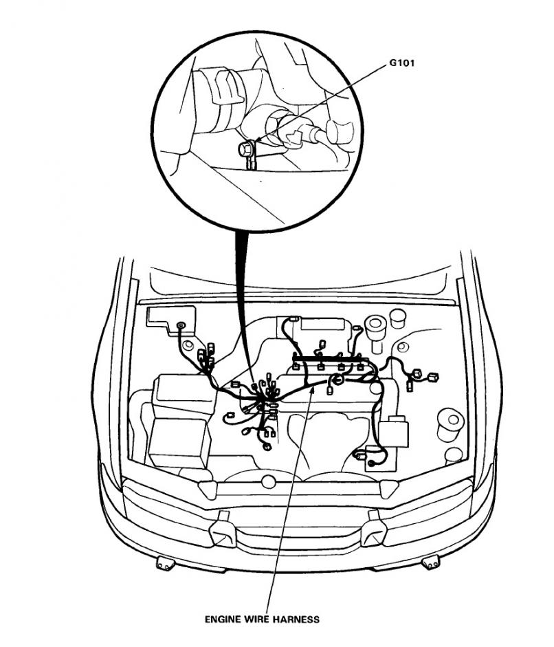

I think that he means the top of the plugs that connect to the spark plug wire were covered in oil. Replacing the 4 seals on top of the valve cover should have taken care of that problem.
You ruled out the ICM by having it tested. There is a grounding point under the distributor on the thermostat housing that you should clean and make sure it is tight. See attached pic.
A coil can pass resistance tests and still fail. The ECU could also cause this problem. If you still have no spark after you clean and tighten that ground, replace the coil.
