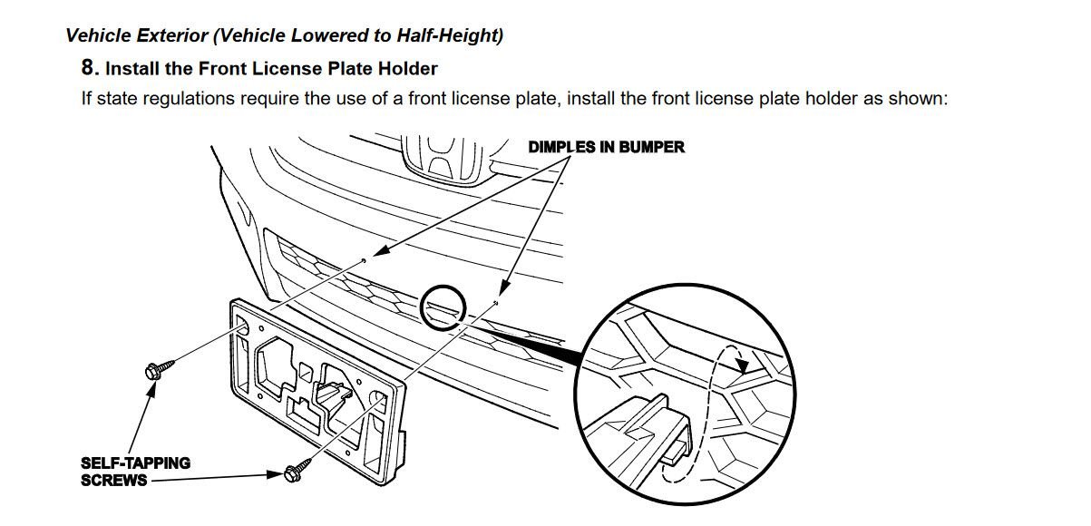

I have 2015 Accord Ex. Need some help with installing front License plate. I do have some parts given by Dealer for the license plates. Not sure if I have everything. Can you point me in the right direction ? Thank you in advance for the help! I have the Part 71145-T2A-A000 and 6 screws with it.
Originally Posted by 21ninny
Was wondering if I can install it without drilling holes. Thanks for sharing this link.
The youtube video posted previously is for 2018 and later Accords. The following is for a 2015 Accord. The screws are self-tapping. Using a drill first makes it easier.
2016 Accords looks like dimples were added to the bumper to act as a guide.
