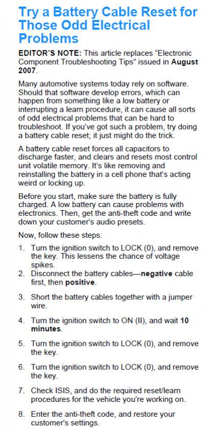

Looking at the diagram, it seems that all your symptoms are common with the drivers multiplexer (MICU), just for giggles, disconnect your batter for about 15 minutes, make sure you have your radio and/or navigation codes, then reconnect and see what happens.

Try what Dr. D suggested. See this attached excerpt from a Honda Service News. You don't necessarily have to follow all the steps in this excerpt.
Just disconnect the battery cable and wait and little bit.
